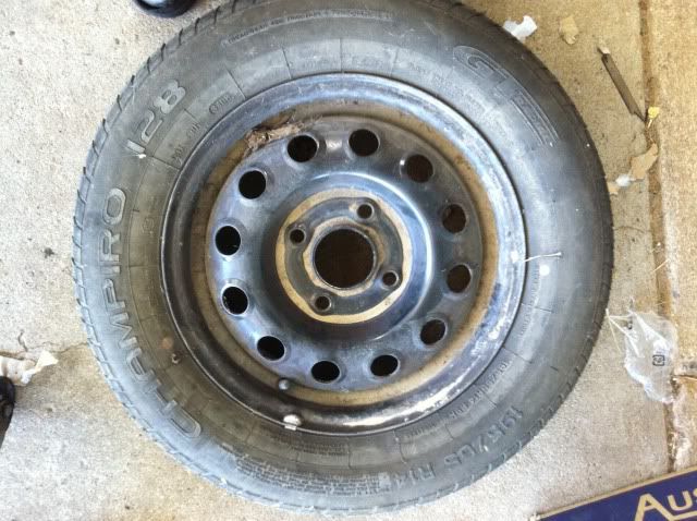

Skyline R31 spare steel wheels
Also same as Nissan Pintara. These are 14" wheels. aka "Pursuit" or "chaser" style rims as they are similar to police car (plain) steel wheels.
Don't pay more than $15 per steel wheel
The 5.5 wide wheels should fit.
