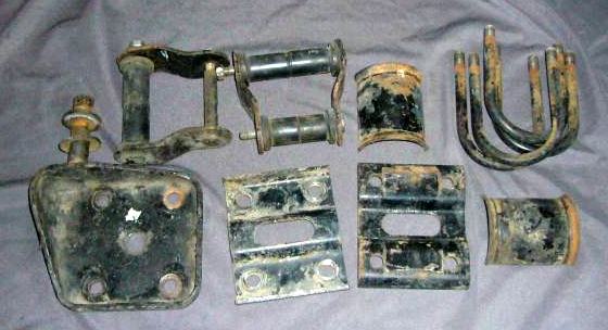

+ | Truck upper mount | ||
+ | <br>[http://datsun1200.com/modules/myalbum/photo.php?lid=18721 http://datsun1200.com/modules/myalbum/photos/18721.jpg] | ||
