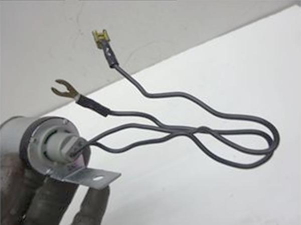

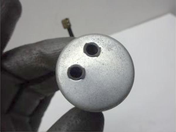

Lamp:
23066.jpgAlbum 23066 30423.jpgAlbum 30423 30424.jpgAlbum 30424

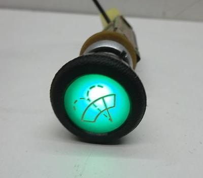

Illuminated Wiper Switch knob
30422.jpgAlbum 30422

Early 620 lamp can. The fiber optic cables plug into the can
