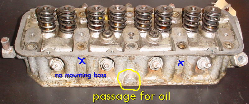

To determine if the head is for an early (pre-1974) or late (1974-up) engine, check for existence of an oil passage here:
Only early engine have the passage in the head here. Of course, one can have the passage drilled on a newer head, but it is a good sign.
To double-check it is an original early head, look at the outside:
Early head: oil passage boss
Late head: no oil passage boss
