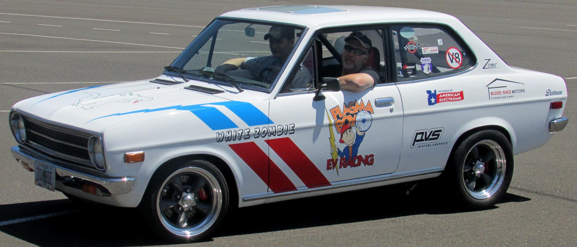

White Zombie is a 1972 Datsun 1200 2-door sedan. As of 2014 it is the world record holder for street legal electric vehicle, running the 1/4 mile in 11.4 seconds @ 114 mph. White Zombie is optimized for 1/4 mile runs, rather than range (miles before it needs a recharge). It's now run 12.99 @ 101 mph and is a member of the "100 mph Club". See POST Wayland's 1200 Breaks World Record.

White Zombie 2004 Specification
  • Dual 8 inch Warfield series wound motors advanced 12 degrees, connected shaft-to-shaft, and wired to either run in series for 0-~70 mph or wired in parallel for 70-115 mph or so (100 mph 6500 rpm)
    evalbumᴬᴿᶜᴴᴵⱽᴱ
  • 10 mile (max) range, or put another way, 40 lazy quarter-mile runs or 1 full-on run
  • 0-60 mph time: 4.5 seconds (estimated)
  • Charging time: Fast-charged in 8 minutes between runs (200 amps)
  • 24 Exide Orbital 12volt batteries -- 288 volts, each battery weighs 40 pounds
  • Previous run with 336 volt pack, but that's a heavy pack!
  • Motor is controlled by a 1400 amp Godzilla motor controller, modified by Otmar, plus my 'Afterburner' controller bypass that connects the paralleled motors around the controller directly to the full pack voltage with ~ 2600 amp power rush...enough to break traction on a sticky drag track at speeds around 70 mph
  • No transmission. Direct drive with a beefy drive line from the rear motor's output shaft, through a center carrier bearing, and onto the input flange of the differential
  • Ford 9 inch rear end with a 4:56 ratio. Currently, the rear end setup has twisted axles, a damaged pinion, damaged gears, a mini spool that locks both axles together, and the smaller street sized 28 spline axles
13601.jpgAlbum 13601
  • Plans for drag racing spec Detroit Locker ratcheting-full locking differential section with the bigger 31 spline axle drives, custom machined drag duty racing spec 31 spline axles
  • street-legal drag tires
  • Tires: Rear....BF Goodrich DOT approved, 215/60/14 'Comp T/A Drag Radials' on Ford 5 bolt, 14 X 7 five spoke Eagle polished alloys
  • Tire: Front...Nitto DOT approved, 175/50/13 'Exit GS' on Nissan 4 bolt, 13 X 5.5 five spoke Eagle polished alloys
  • Wheels: The front are 4-lug (standard Datsun suspension) with spacers. The rears are 5-lug to match the Ford 9" diff assembly, which is considerably wider than the stock axle
  • "slapper-bar" style traction aid
  • rare Datsun Competition 10 grand tachometer (Kantoseiki, optional, not the 8k rpm option tach)

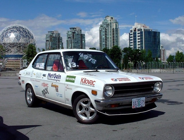

  • ran a class SC/A best of 13.18 seconds @ 99.19 mph at the May 27th Denver races
After the record low 13 second run, the Hawkers started their downward decline in performance as they aged and had ever more racing cycles put on them, and the ET's began to get worse, averaging mid 13's, then high 13's. I fried the Kostov at the 2000 Labor Day weekend Woodburn races when the armature's copper windings melted.
In time for the October Sacramento NEDRA drags, I switched to running dual 8 inch motors with the same tired pack of Hawkers. The change to twin smaller motors was encouraging, when White Zombie with no other changes made, dropped down from the high 13's to the mid 13's.
Two years after White Zombie's peak of performance, though the Hawkers were pretty much shot, I tried one more trick at the 2002 Woodburn drags...408V, by adding a booster pack of 6 extra Hawkers in a controller bypass affair, the car was able to maintain high 13's with an old battery pack.
