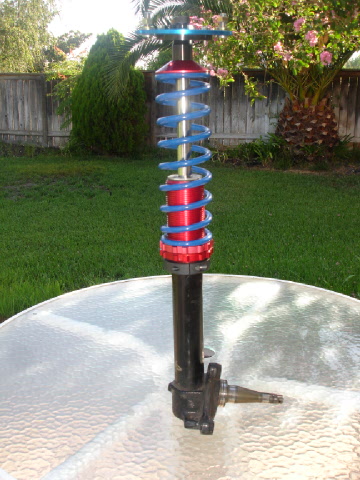

Coilover seats are suitable for the small diameter springs. most use a threaded collar which slips over the strut tube. This is the part to be fastened to the tube. But simpler stop seats are available too which don't use a threaded collar.

Welding Method
Welding the spring seat to the strut body is the generally accepting fitting method. Options include:
  • Seat welded directly to strut body. This is how the factory did it
  • A seat stop is welded to the strut body
  • Hybrid: a seat stop is welded to the seat, then that assembly welded to the strut body
Notice the secure welds in this photo, at the bottom of the threaded sleeve:
