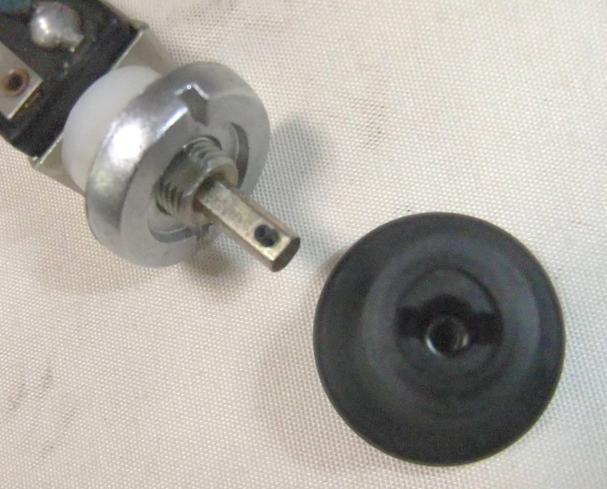

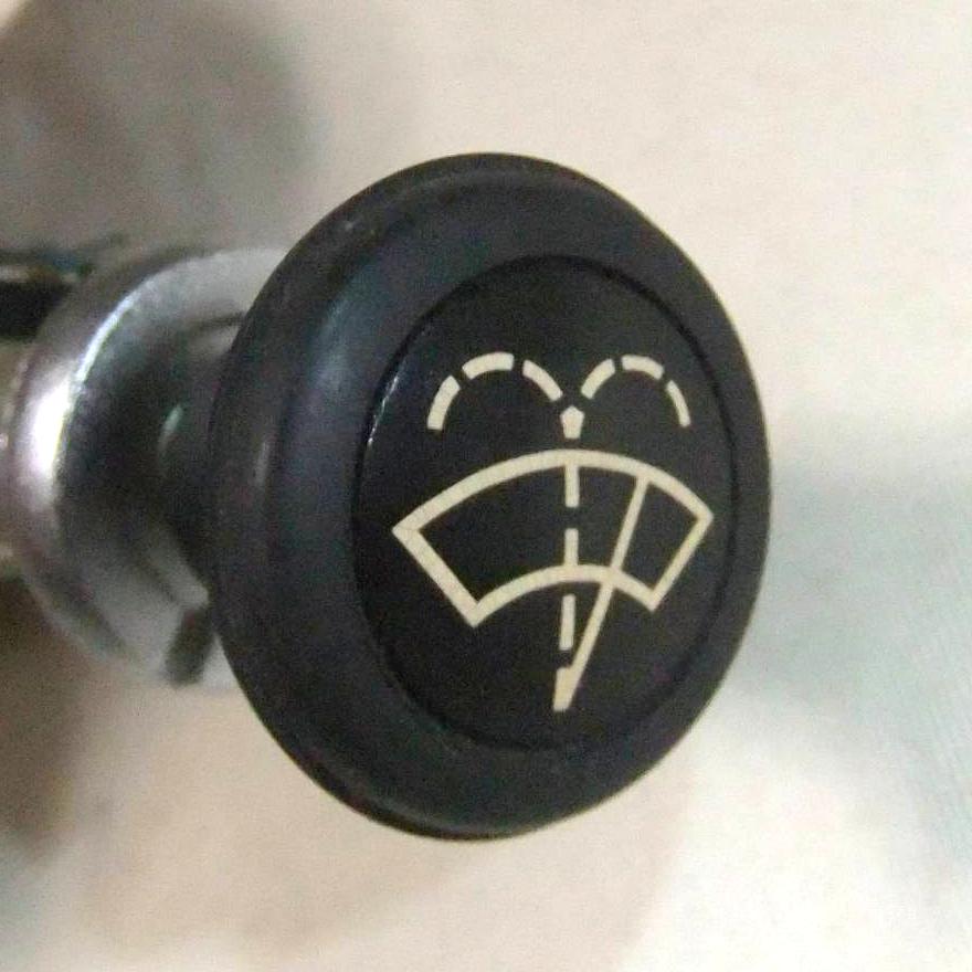

All 620 wiper switches use Datsun 1200 knobs (type H10 or H70). To remove, push in and turn counter-clockwise p
30427.jpgAlbum 30427 30431.jpgAlbum 30431
Main: Knobs

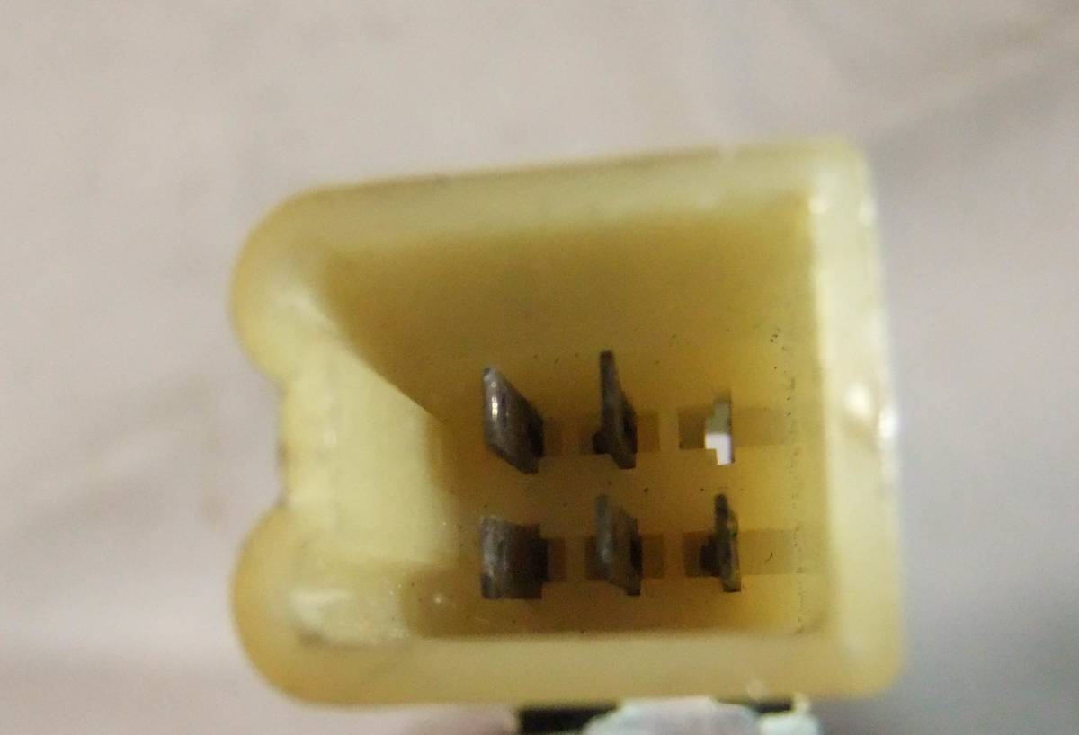

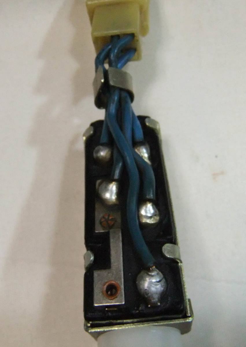

USA Dash Harness
1972-1975 yellow square connector
      * 5-spade terminals for switch
1976-1977 white rectangle connector
      * 5-spade terminals for non-intermittent switch
      * 6-spade terminals for either switch
      * intermittent switch uses a sub-harness

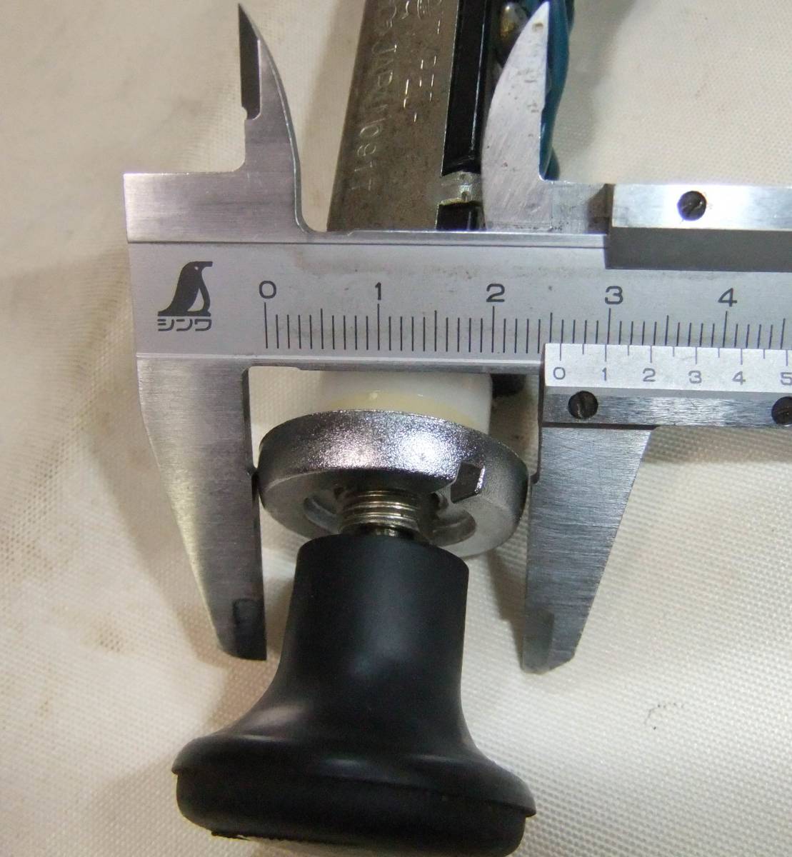

Escutcheon is 26mm diameter

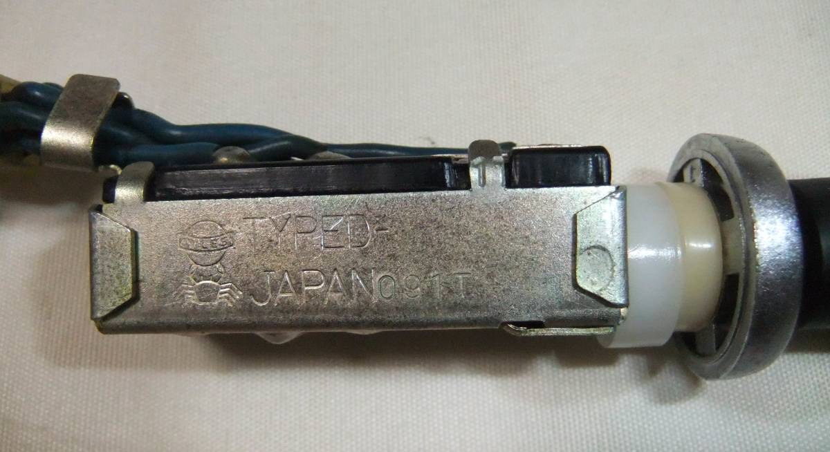

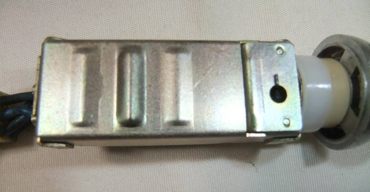

25260-B5000 JDM non-intermittent 'NILES TYPED- JAPAN 091T' (NILES WS-620A)
30425.jpgAlbum 30425 30426.jpgAlbum 30426 30432.jpgAlbum 30432
Wiring appears to be identical to Datsun 1200 standard Wiper Switch
30428.jpgAlbum 30428 30430.jpgAlbum 30430

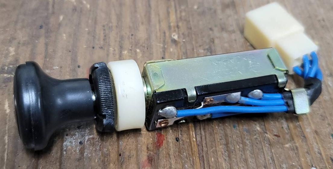

25260-B6000
rose311sr-img600x450-1229508149e240xk59909.jpg rose311sr-img600x450-1229508149kavvzy59909.jpg rose311sr-img600x450-1229508149rbqid859909.jpg
