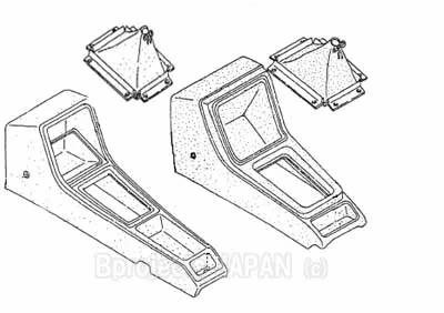

Overview
Datsun B310 Sunny/210 consoles came in short or long versions. They are the same, except the long one goes further back under the emergency brake handle, and the short one has one rear mounting screw.

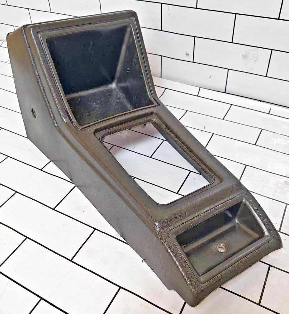

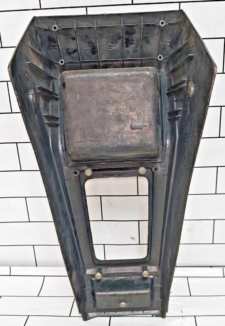

Small console

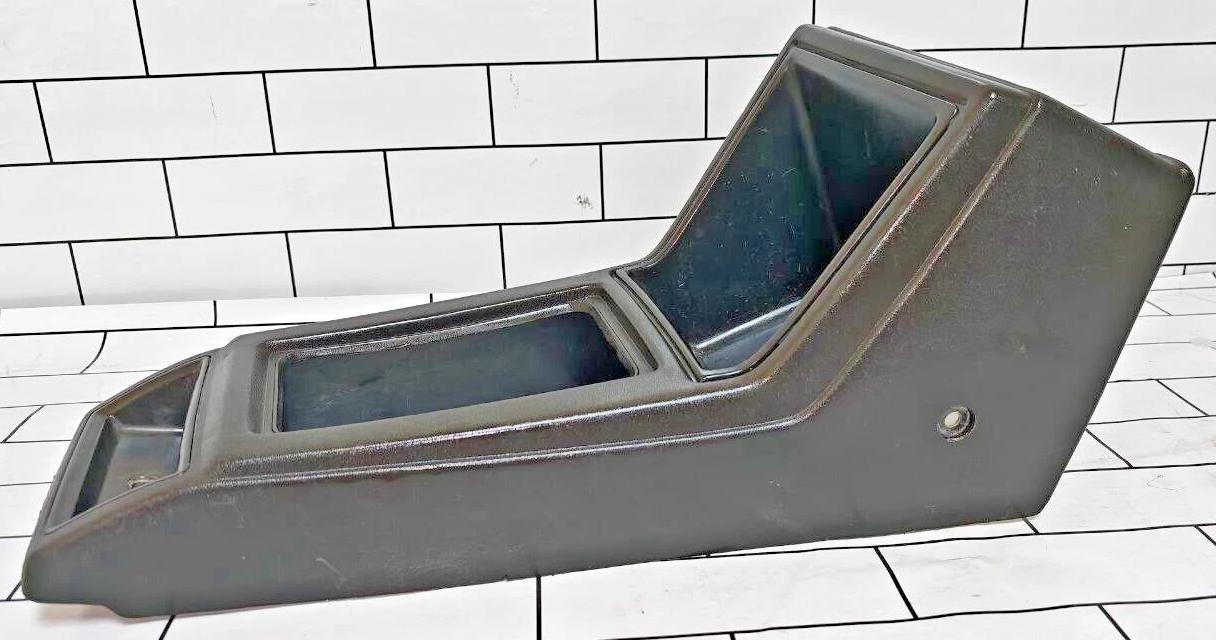

The short console is relatively rare, only applying the DX models. It came in Black or Brown.
Uses the same mounting bracket as the large console.

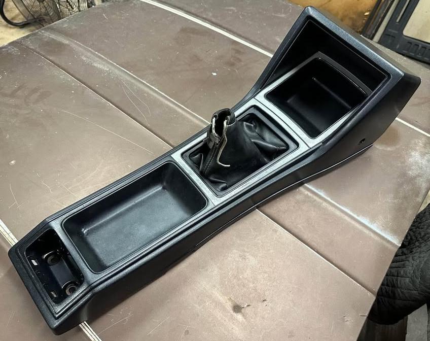

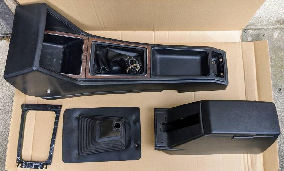

Large Console
Uses the same mounting bracket as the small console.
174_68d717170786c.jpgPost 499057 174_68d7171e3c3cc.jpgPost 499057 174_68d71728559f2.jpgPost 499057 174_68d717622e267.jpgPost 499057

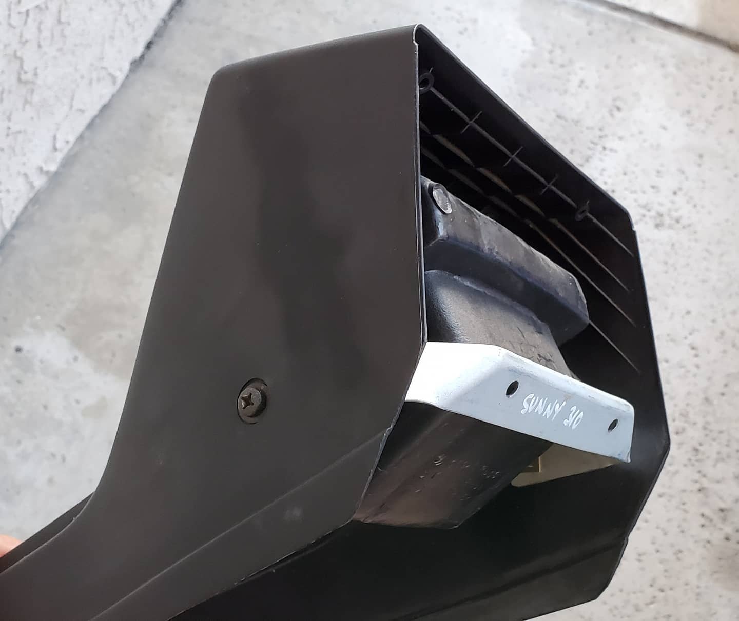

Bracket (same as short console)
174_68d7768942f8d.jpgPost 499060

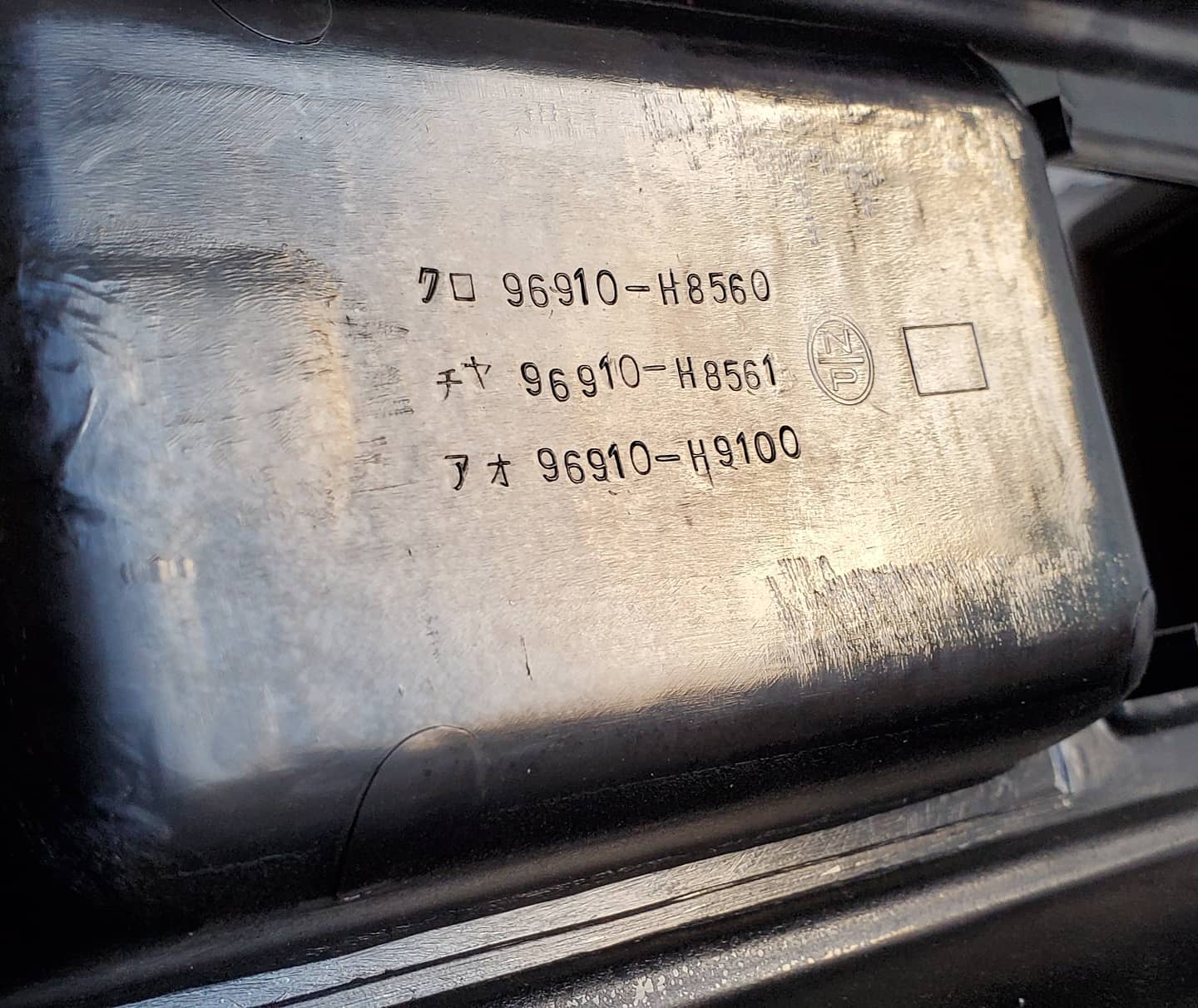

Tray bottom markings
174_68d7769b3f6bb.jpgPost 499060
N-P
クロ 96910-H8560 [black]
チヤ 96910-H8561 [charcoal]
アオ 96910-H9100 [blue]

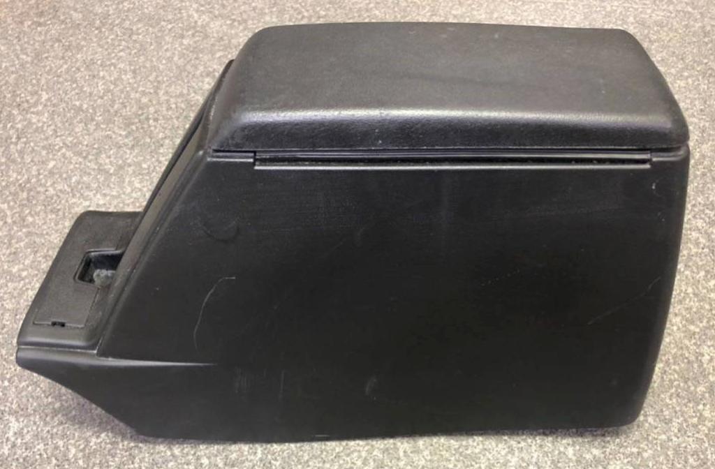

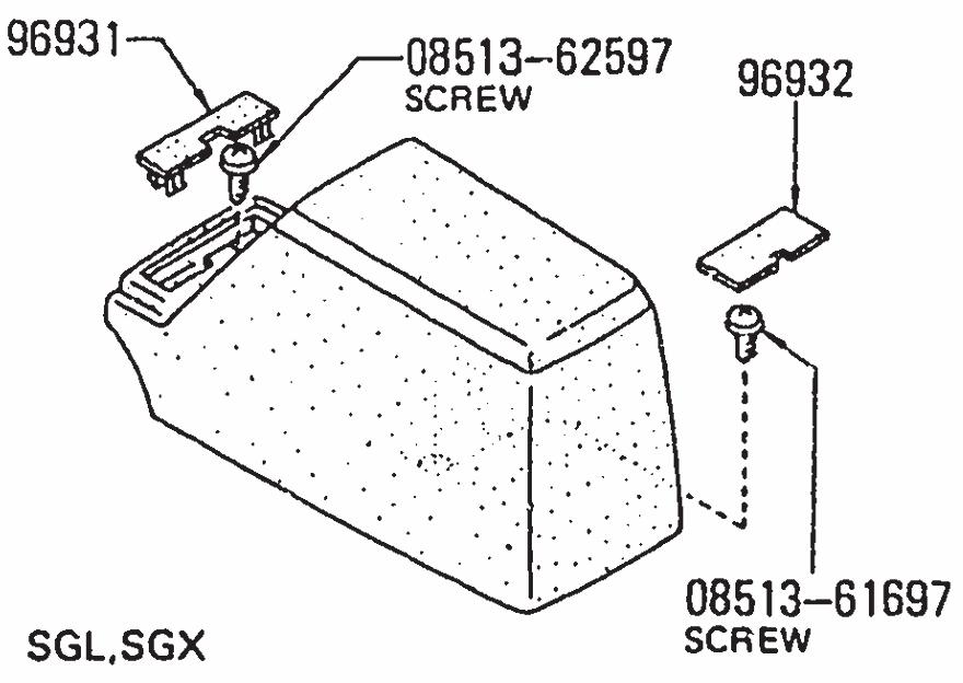

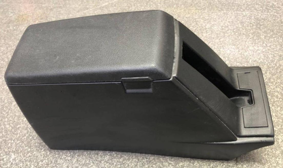

Armrest

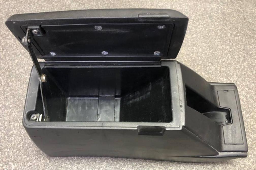

For the SGL and SGX trims, optional for Van Super Deluxe. Remove the large console bolt cover, then bolt on this box armest using longer screws.
174_68d7764d694c8.jpgPost 499060 174_68d7761688d78.jpgPost 499060 174_68d77627522ed.jpgPost 499060 174_68d77635d805e.jpgPost 499060

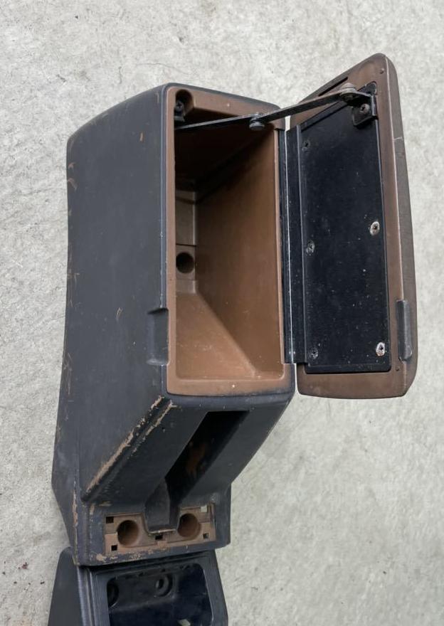

The lid hinge appears to be plastic and often breaks. Some replace it with an external metal hinge
174_68d7756e0a9a8.jpgPost 499060
174_68d77cc7a7153.jpgPost 499060
CONSOLE BOX LID for SGL and SGX
96920-H7825 BLACK
96920-H7826 BROWN
* Sunny California GL
08513-62597 SCREW (2) [front]  Tapping screw, Pan head M3.5 x 25mm
08513-61697 SCREW (2) [center] Tapping screw, Pan head M3.5 x 16mm
96931 COVER-FINISHER ARM REST [for armrest front screws]
      96910-H9110 COUPE.ES BLACK F/INDICATOR
      96910-H9111 COUPE.ES BROWN F/INDICATOR
      96910-H9113 COUPE.ES 8011- BLUE
      96926-H8901 OPTIONAL VAN.STD 8011- BLACK F/STEREO
      96926-H8902 OPTIONAL VAN.STD 8011- BROWN
      96927-H8560 BLACK
      96927-H8561 BROWN
      96927-H8920 OPTIONAL 8011- 2S.A13.DX, 4S.GL, 4S.A15.GX-A15S.F4
96932 COVER [for armrest center screws]
      96928-H8560 BLACK
      96928-H8561 BROWN
Brown can be repainted black

* large console box ALL trims except Standard and Deluxe
* small console box SEDAN and COUPE Deluxe
* no console box - Standard models and Deluxe Van
SMALL CONSOLE BOX - Deluxe SEDAN and COUPE
174_68d70dfb4d6b3.jpgPost 499056
LARGE CONSOLE BOX - ALL trims except Standard and Deluxe
174_68d71975ba838.jpgPost 499057

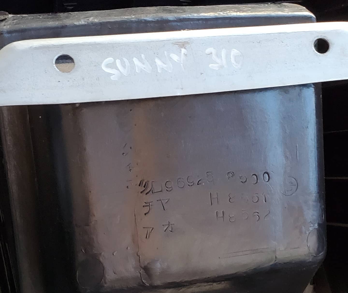

#Pocket bottom markings
174_68d77693951f7.jpgPost 499060
クロ 96925 8500 [black]
チヤ H8561 [charcoal]
アオ H8562 [blue]

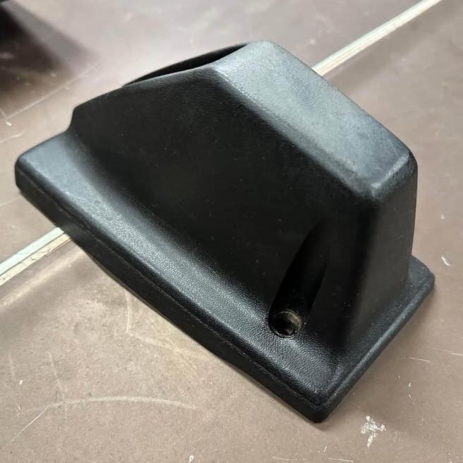

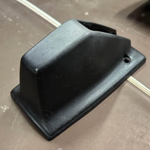

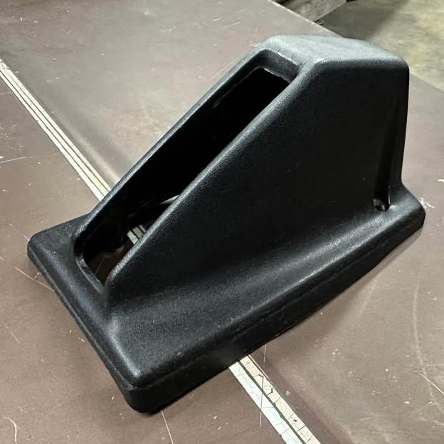

Parking Brake Lever Cover
The brake cover is a complement to the console.
74980Y COVER ASSEMBLY-PARKING BRAKE LEVER
74965-H8502 BLACK
74965-H8503 BROWN
08513-61697 SCREW (2) Tapping screw, Pan head M3.5 x 16mm

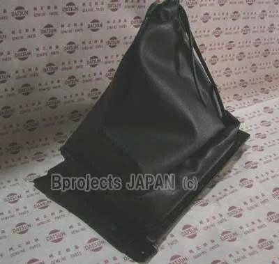

Shift Boot
B310 uses larger shifter boot than the one fitted to the B110 shifter boot. It has bolt holes for fastening, unlike the B110 boot.
Sold by Bprojects
174_68d7075073eb3.jpgPost 499055 174_68d707478d76b.jpgPost 499055
174_68d7074118e80.jpgPost 499055
96935-H8500 BOOT (BLACK)(G) <> 96935-H8560 $35.58 USD
96935-H9160 BOOT (BLUE) 0879- $32.62 USD
96935-H9100 BOOT (BLUE) -0779 $30.12 USD
96935-H8561 BOOT (BROWN) $35.58 USD
