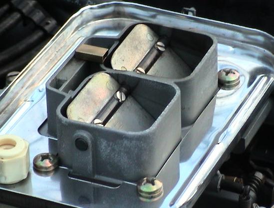

  1. Remove air filter so you can see the choke butterflies
  2. Move by hand the throttle about 1/2 way

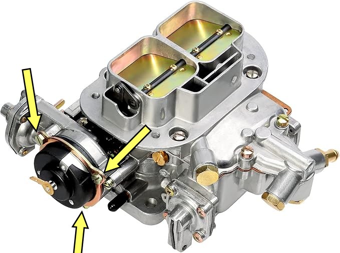

  3. If the choke doesn't close 100% ...
30727.jpgAlbum 30727
... loosen the three choke screws. Turn the choke housing anti-clockwise until the choke just barely closes 100%
30728.jpgAlbum 30728
Then, re-snug the screws, replace air filter, and test: a single pump of the accelerator pedal and foot off. The engine should start, idle by itself at 1,500 to 2,200 RPM. You can immediately start driving. Or if you let it idle, periodically tap the throttle to let the fast idle come down
Once engine is fully warm, remove air filter and verify that choke is 100% open.
