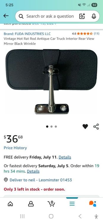

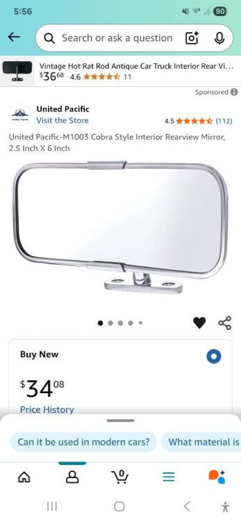

If you keep the 1200 base, any 1/2 inch ball-mount mirror will fit:
MoonEyes GT650
Cobra Style Interior Rearview Mirror, 2.5 Inch X 6 Inch
black finish
Screenshot_20250702_172538_AmazonShopping.thumb.jpg.d3a0c3608d1498e06adc6e74a5373db7.jpg
chrome finish
Screenshot_20250702_175645_AmazonShopping.thumb.jpg.4da6b9f4aefbffa55181c8bddc36889c.jpg
