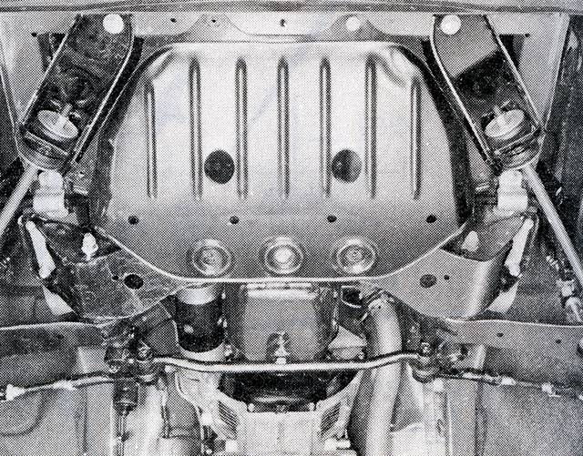

The tension rod is the lower bar in this photo:
