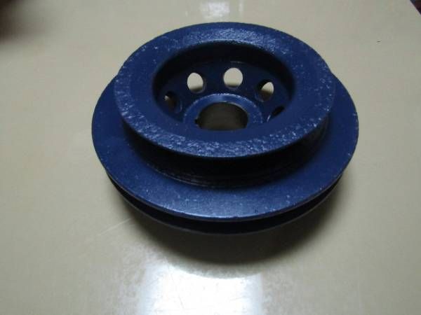

Twin-groove pulleys
dual-pulley/twin-groove/double sheave
Type G16 129/129 mm with large center
Type H50
Type H72
Type H8900
Type H8905
G16 - Sunny Truck from 7908
Large center
Large/large sheaves
PULLY-1.jpg PULLY-2.jpg 20597.jpgAlbum 20597 28570.jpgAlbum 28570
Small center with puller holes
Large/small sheaves
28578.jpgAlbum 28578 20596.jpgAlbum 20596 20080.jpgAlbum 20080 28571.jpgAlbum 28571 pulley_dual-1.jpg pulley_dual-2.jpg
Large/medium sheaves
25112.jpgAlbum 25112 28568.jpgAlbum 28568
Holey center
