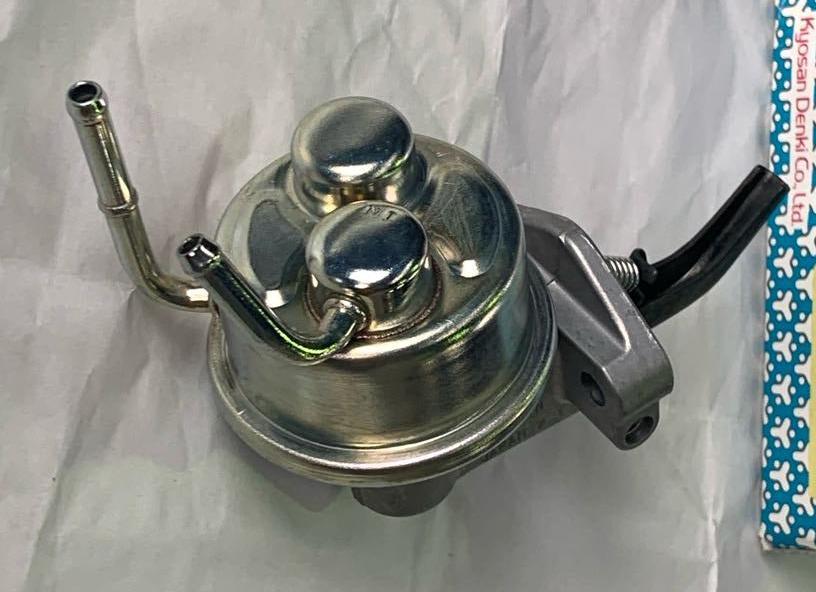

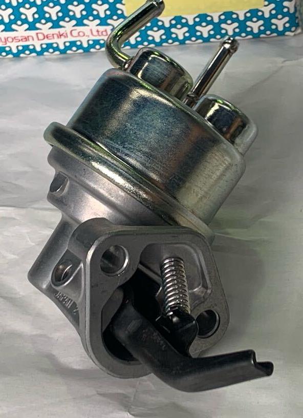

B210 Fuel Pump
For A engine redesign
Kyosan Denki NP-918 sealed top is non-rebuildable
31276.jpgAlbum 31276 31278.jpgAlbum 31278
31277.jpgAlbum 31277

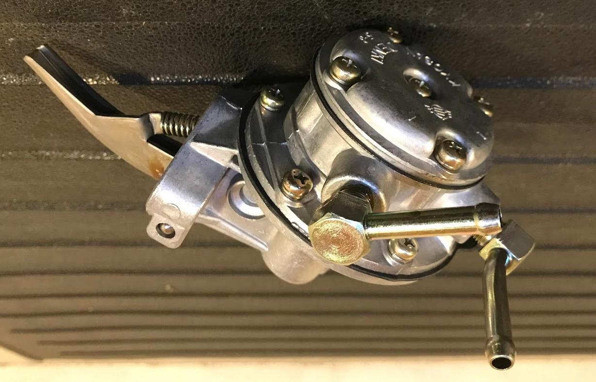

                        NP606 5-bolt top [USA] 76-
NP-606 5-bolt top, screw-in ports
31279.jpgAlbum 31279
