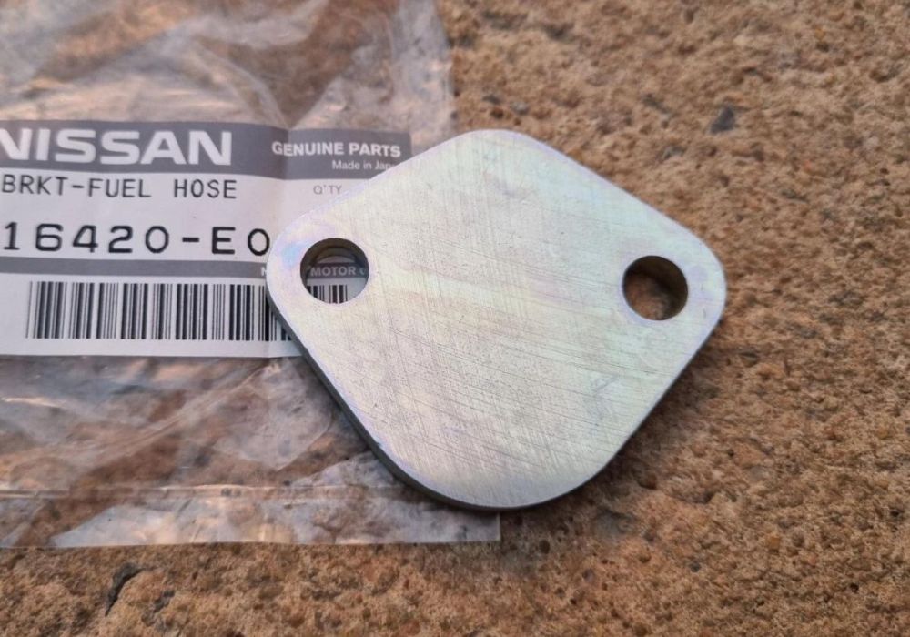

For use with Electric Fuel Pump. Instead of leaving the stock mechanical Fuel Pump in place, it may be removed and the blanking-plate fitted. Also known as a delete plate, cover plate, block off plate or fuel+plate1200.

Nissan fitted a blank-off plate to the A14/A15 fuel injected engines in Japan. The same plate was used in most countries for other Nissan engines. 16420-E0100.thumb.jpg.a78a19a7645f4c3570bf184e3740b61f.jpg
find online 16420-E0100
Nissan 16420-E0100 COVER-FUEL PUMP HOLE $16.10 USD NLA
* 08915-13810 WASHER, spring lock medium M8 (2)
* 08120-81210 BOLT M8x12 (2)
* 17099-21002 GASKET-FUEL PUMP
* Fits A-series, L-series 4-cylinder, E-series, Z-series engines
When fitting the cover plate, unscrew the fuel pump studs from the block, then use two bolts to fasten the cover to the block.
