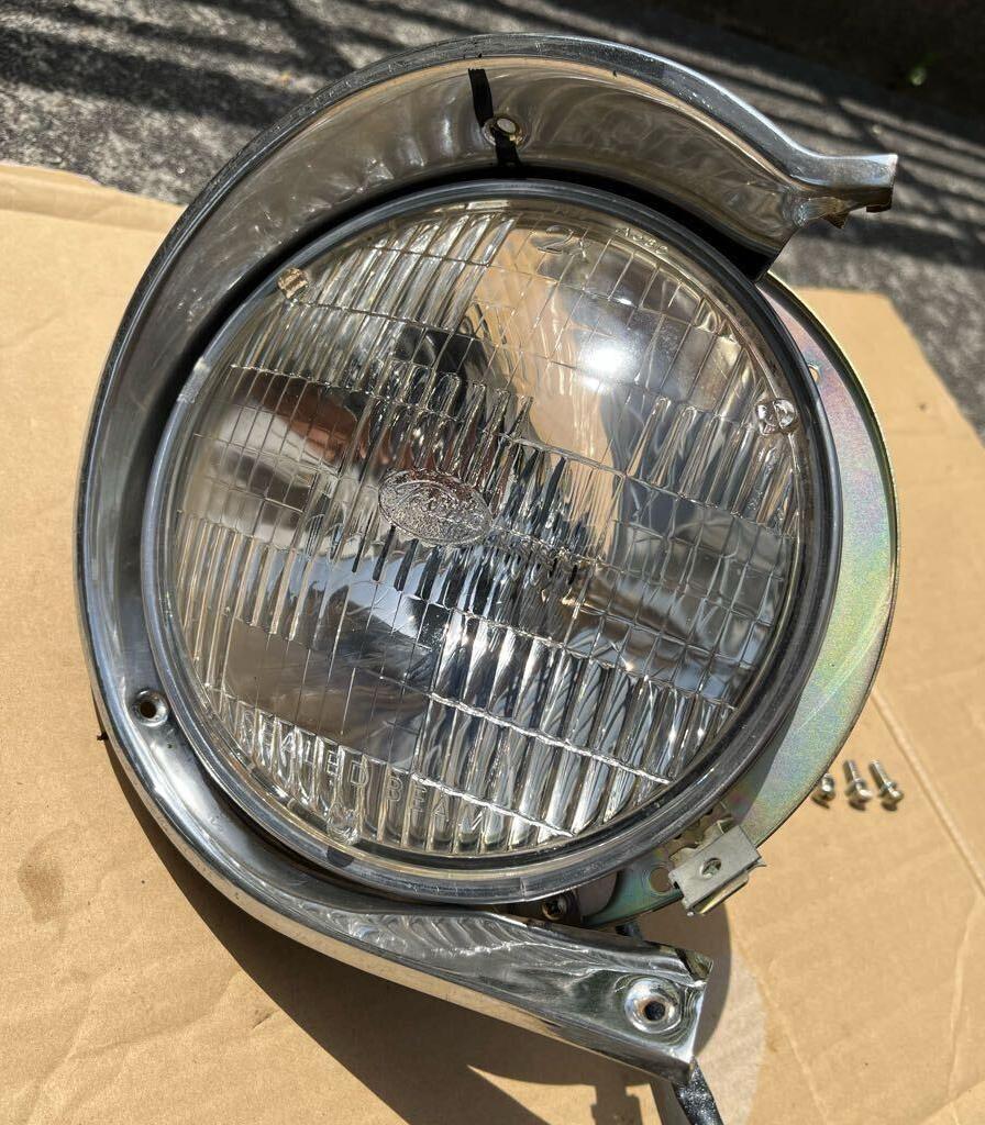

Datsun 1000 uses the standard 7-inch round sealed beam headlamp. 12V large round headlights from *any* car will fit circa 1956-1986. Original equipment was Koito and Ichikoh (IKI).
The parts around the sealed beam are unique to the 1000, including buckets, adjusters and trim rings.

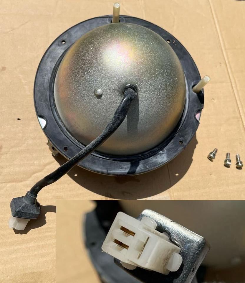

20674.jpgAlbum 20674
The assembly has an intermediate bulb connector harness, but inside it is a standard 7" sealed beam.
