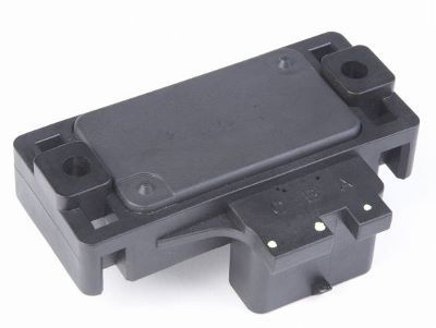

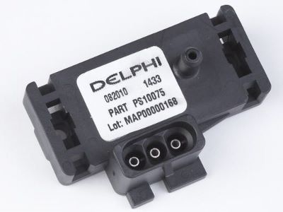

MAP sensor
* DELPHI PS10075
  * Daewoo Lanos 1999 1.6
  * Isuzu Pickup 1991
  * GMC Jimmy 1987
  * Honda 8125692400
