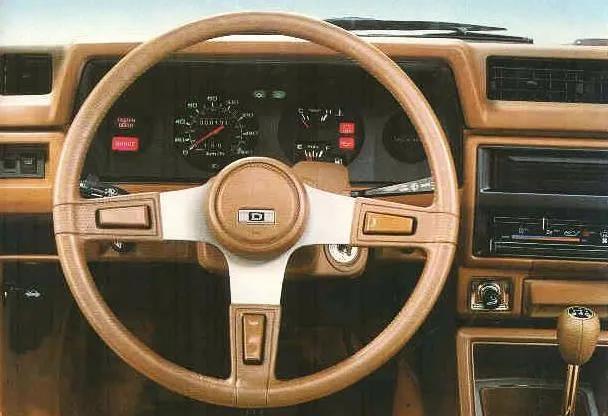

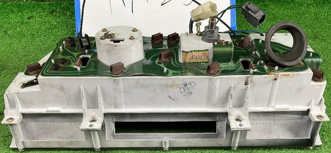

Late
1980-1982 switched to a smaller driver's "cockpit" that included just the instrument panel — the radio and center vents were outside of this area. Japan vans stayed with the early style.
H85 single side gauges
    Speedometer + Idiot Lamps S,W except SGX
    Speedometer + Tachometer Coupe except SGX
H92 double side gauges S,K.SGX
2+4 cluster SGX
174_667c8a828375f.jpgPost 498535

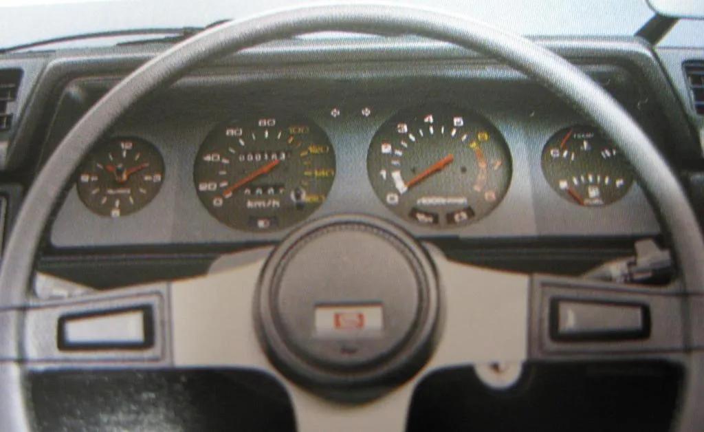

210 (North America) 1982 2 large gauge + 2 small gauge with blanking plate
174_634fbc1c24f96.jpgPost 497226

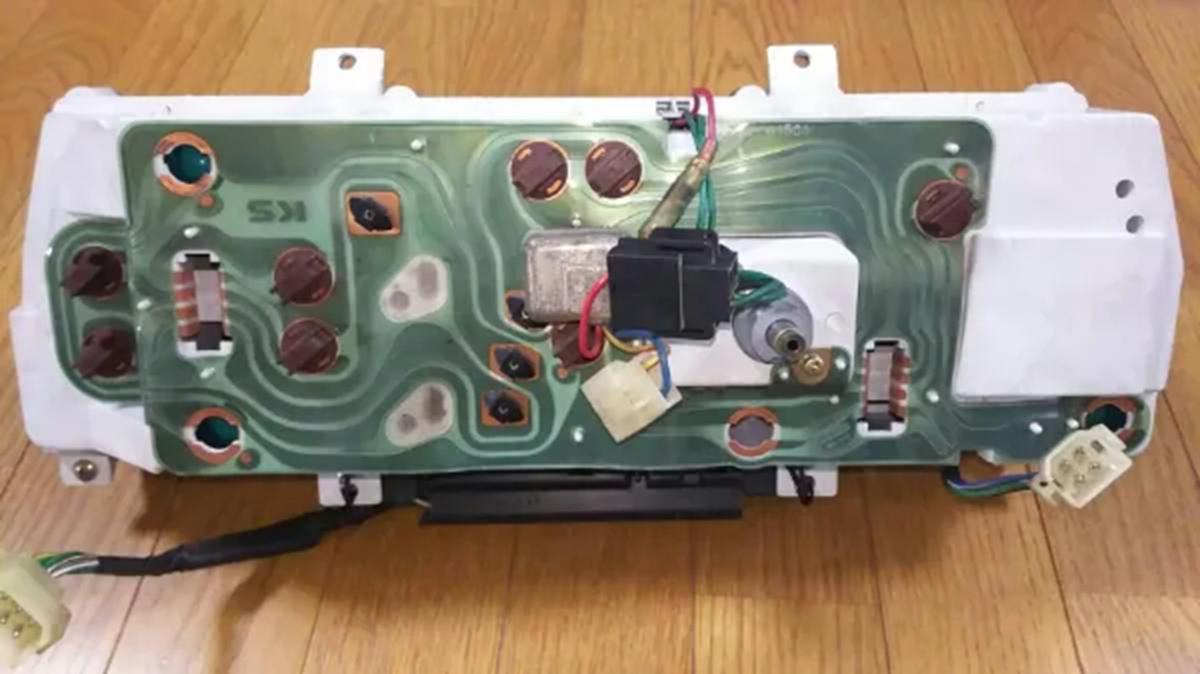

With Digital Clock
174_634fbbfd383dd.jpgPost 497226 174_634fbc2a44644.jpgPost 497226 31161.jpgAlbum 31161

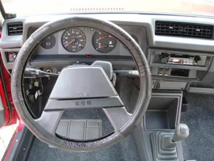

With Analog Clock
29593.jpgAlbum 29593 8016765852_0b28acaa3d_z.jpg 174_634fbc3eee7c2.jpgPost 497226
174_634fbc4962747.jpgPost 497226 174_634fbc5a2bceb.jpgPost 497226

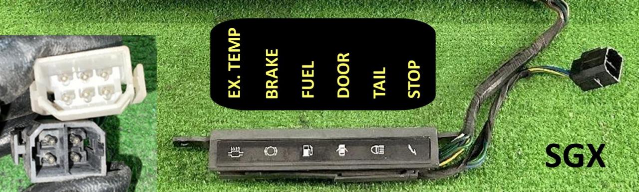

Monitor Lamp Strip
Six variations, including two blank strips.
Masks are placed at bottom of cluster (where photo is labeled "Delete Plate")
31163.jpgAlbum 31163 31162.jpgAlbum 31162
Inspection Monitor Lamp strip 25040-H8563?
31165.jpgAlbum 31165 31166.jpgAlbum 31166
SGX with full Monitor Lamps (all six icons)
31164.jpgAlbum 31164
68450-H8501 MASK 7910- CT,S.DX,SPT,ES+W.DX, SGX
25040-xxxxx LAMP ASSY [six variations]
      H8500 EXH TEMP,BRAKE,FUEL
      H8562 FUEL,DOOR
      H8761 EXH TEMP,BRAKE,FUEL,DOOR,TAIL,STOP
      H9201 EXH TEMP,BRAKE,FUEL,DOOR
      H8563 FUEL,DOOR,TAIL,STOP
      H8611 CT/DX [blank]
      H8761 SGX [blank]
