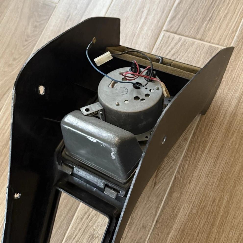

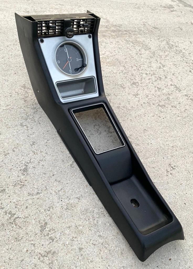

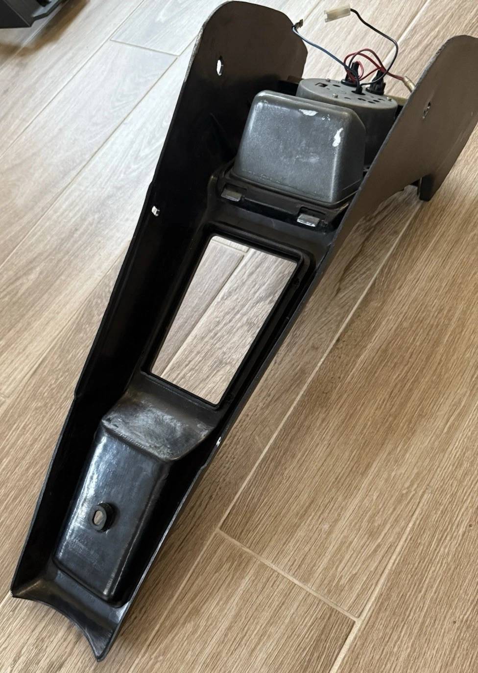

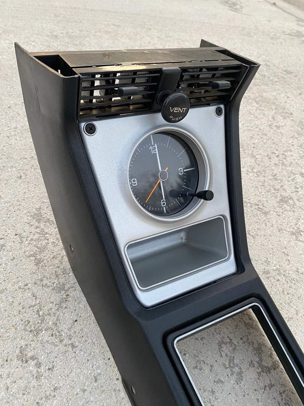

Clock
Type H26 clock with cubbyhole
30530.jpgAlbum 30530 174_68b4e9e9b0240.jpgPost 71224
* GX with clock
* GL with clock mask (Sunny blanking plate)
74982-H2600 GL,GX MASK-console box body
74992-H2600 GL    MASK ASS'Y-clock ['Sunny' plate]
27380-H2600 GX    CLOCK ASS'Y
