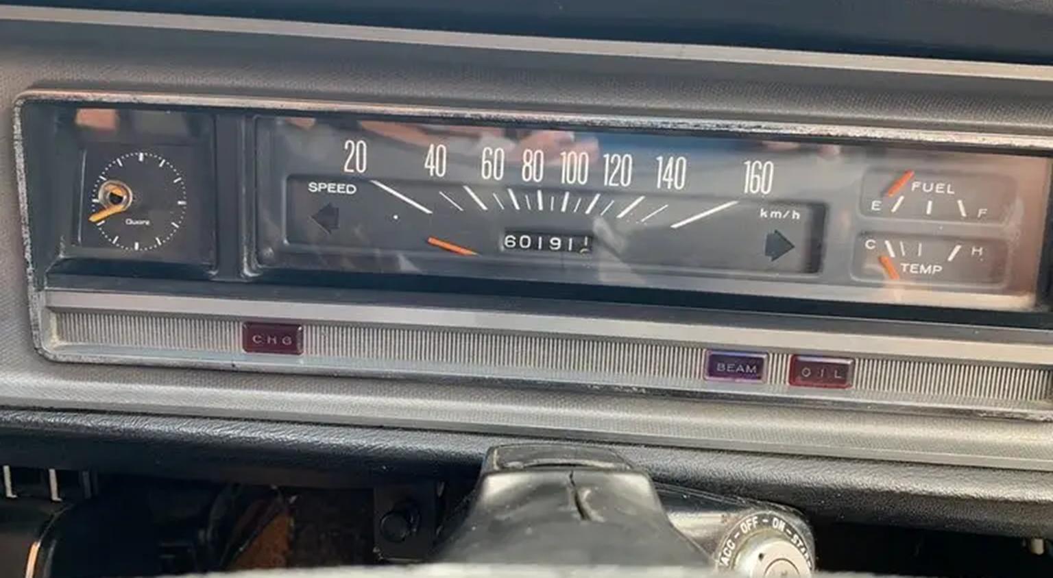

Factory clocks were optional in all 1200 models for either rectangular or round style dashes. It was standard equipment on GL & GX models where the clock was fitted the Console, while other models fitted the clock in the instrument panel to the left of the speedometer.

H10 original clock for STD or DX model

The clock bolts into the dash by using the tabs along the face. Unbolt the mask and bolt in the clock.
click
The tabs further back on the body are used for mounting in the floor console.
