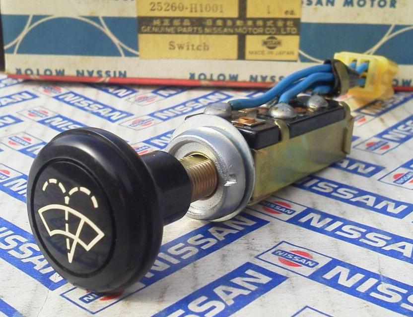

Datsun 1200 came with two different wiper switches.
  • New (intermittent) Wiper Switch: rectangular 6-connector
  • Old (original type) wiper switch: square 6-connector with blue wires
22432.jpgAlbum 22432
Do not confused with the Lighting switch — both have the same connector.
New Wiper switch (intermittent type) has one blue wire.
22433.jpgAlbum 22433
Intermittent Wipers for 1200s April 1978 and newer
  • 25260-G1060 SWITCH ASSY-WIPER [six spade connector]
22431.jpgAlbum 22431
19671.jpgAlbum 19671

25260-H1001
standard wiper switch 25260-H1001
