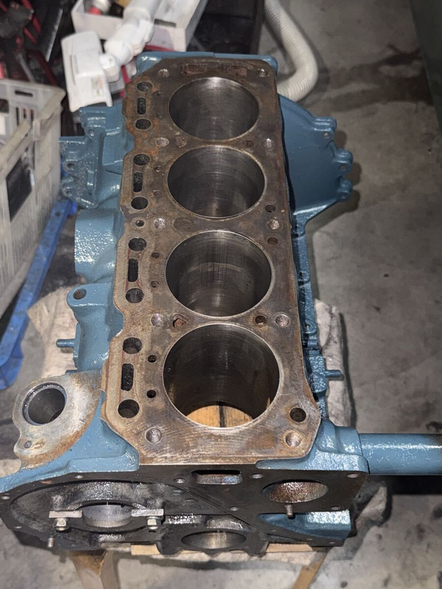

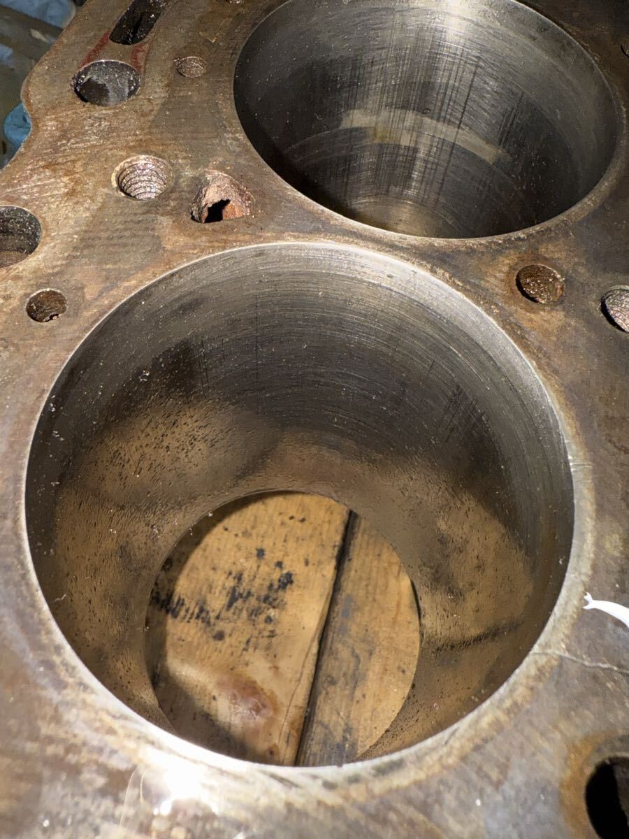

80mm overbore A14 - 1548cc
23203.jpgAlbum 23203 23196.jpgAlbum 23196
With a cylinder liner, it *may be* possible to go up to 81mm sleeved before combustion chambers are off the mark from too much offset.
Piston dish is important. You want to end up with a near-same compression ratio. Or even better, with 10:1 compression and use premium fuel.
