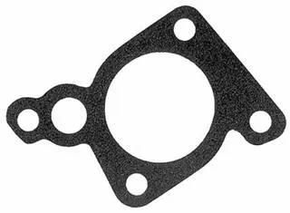

Gasket Types (2-bolt, 3-bolt, 4-bolt)

The 4-bolt gasket works on a 2-bolt housing.

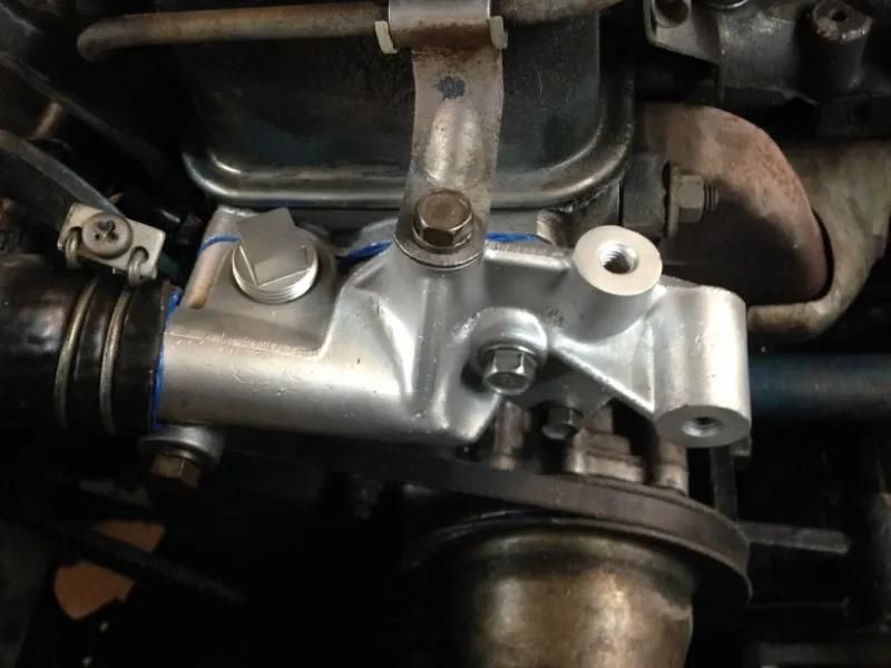

3-bolt type fastening housing to head. With two accessories bosses pointing up
25735.jpgAlbum 25735

11062-H7201 GASKET-WATER OUTLET
All engines with Air passage in the cylinder head require a 4-bolt housing and gasket. Some newer engines without Air system also use the 4-bolt kit.
