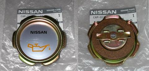

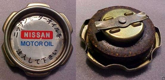

The stock Datsun 1200 Rocker cover uses a push-and-twist oil cap. It is a classic all-chrome cap and seals with a simple round gasket. Some other Datsuns use a threaded cap that will not work in a 1200. By the way, this is where you add oil to the engine.

Part Numbers
B110
15255-B3430 CAP-OIL FILLER 1 A12 - 15255-15953 $12.12
15255-15953 CAP-OIL FILLER 1 A12 - superceded
15270-B3400 PACKING-OIL FILLER CAP 1 A12 - 2 15270-11200 $1.40
15270-11200 PACKING-OIL FILLER CAP 1 A12 - superceded
2-3/4" Oil Filler Cap (1-13/32" x 1-19/64" Cam Twist) RockAuto.com
  • 15255-B3430 Cap-oil Filler $12.35
    • replaced 15255-15953 CAP-oil
  • NOT BECK/ARNLEY Part # 0160048 screw-in cap (fits L-series)
  • STANT Part # 10102
  • GATES Part # 31088
Photos
B10 Datsun 1000 Vented Oil Cap
(Datsun 1200 caps are sealed)
Late Model Sunny Caps
