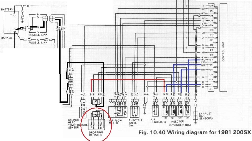

Electrical Signaling System The 1980 system does not use an oxygen sensor, but the 1981 model does.
1981 200SX Wiring
Click: wiring diagrams
Injector Wiring for the 1981 ECU:
Also see EGI Wiring for more information.
