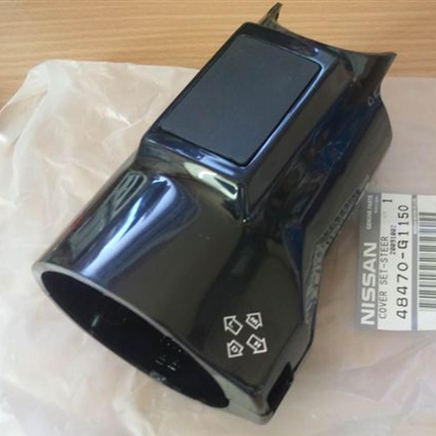

Early (Black)
* 48470-G1150 COVER SET-STEERING COLUMN [Black] 7510-7803
