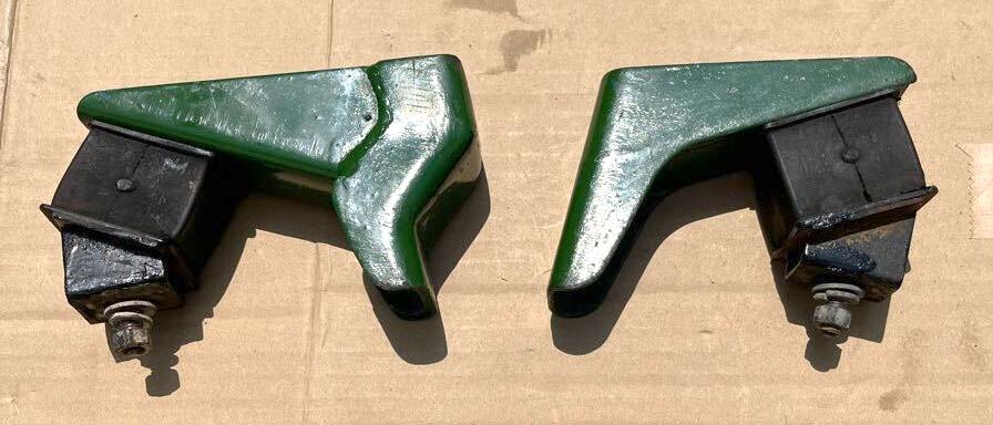

Early Engine Mounting
1970-1973 Datsun 1200 uses bracket that fit the early A12 engine. Note that the left-side bracket is stepped to fit the engine block.
20925.jpgAlbum 20925 19820.jpgAlbum 19820

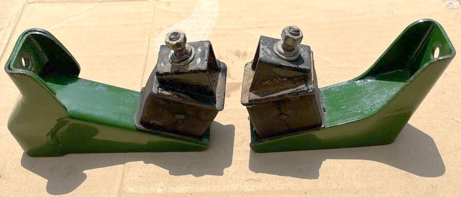

Late Engine Mounting
1974 and up engines are different, and 1974-up 1200s use a corresponding crossmember
20924.jpgAlbum 20924
