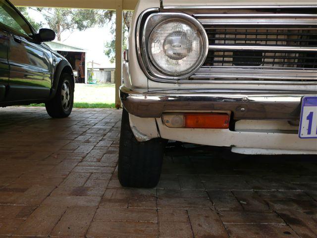

1.5 degrees negative camber can work well for racing or spirited driving. Large amounts of -VE are mainly for looks — for performance you want the tread parallel to the pavement. But since the car leans in corners, having some negative camber keeps the tire tread parallel to the pavement even when leaning.
3 degrees negative camber (top of tyre leaning in)
