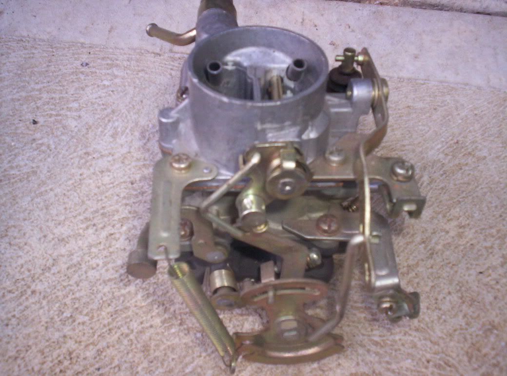

DCG286
Small bore carburetor for Datsun B10 A10 engine
DCG286-3 (see ID numbers

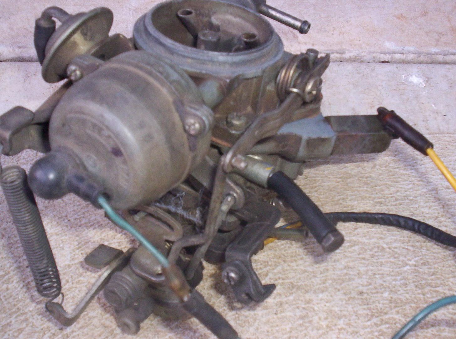

DCH306
1973-1982 DCH is the Automatic Choke series. It had mechanical secondary linkage.
DCR306
DCH-306 with vacuum-operated secondary throttle. 1981-1982 USA models.

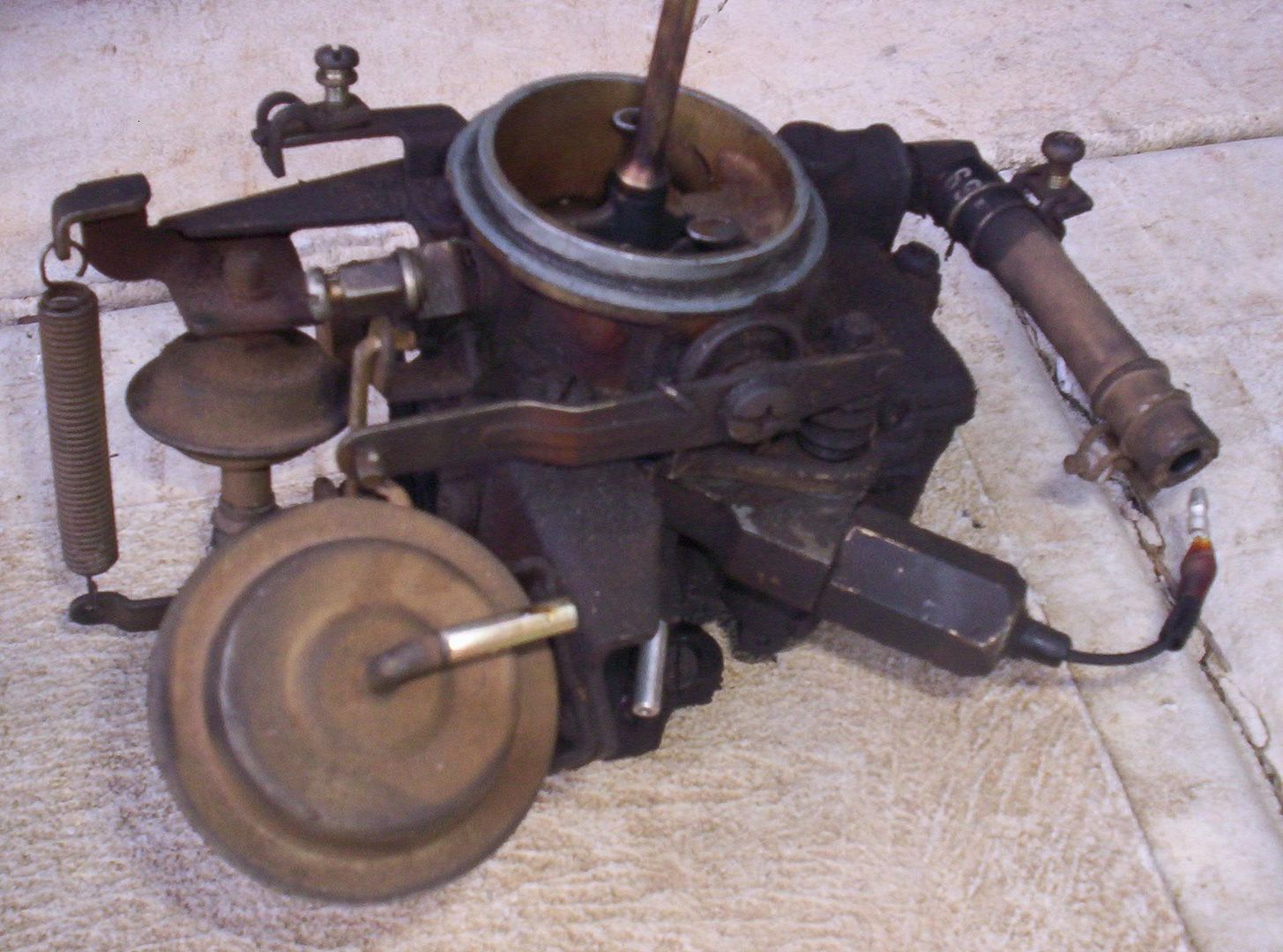

DFC306
Feedback carburetor DFC306 is the carburetor on 1989-1994 JDM A12 engines. It requires a special water heated Intake Manifold and ECU control for the electronic feedback (closed-loop mixture control).
See main article: DFC306
