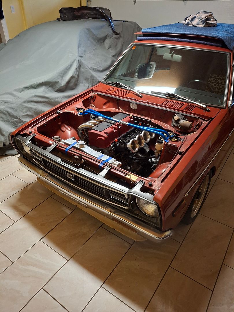

E-series OHC
See Main Article: E-series Engine Swap
E15, E15ET, or E16 OHC engines. These are plentiful in mid-80s Pulsars and Sentras, are the replacement to the A15 and have plenty of go-fast parts available.

Honda K engine
Honda K24A2 from 2004-2008 Acura TXS
Honda K24A2   197-205hp  155kg
Nissan KA24DE 143-154hp  167kg
Ratsun: ka24de 210/K24A B310

POST mrwilson had this Turbocharged 7M-GTE 1992 Supra six-cylinder engine in his ute.
29483.jpgAlbum 29483 29484.jpgAlbum 29484
It was for sale in 2010: Nissan 1400 turbo
