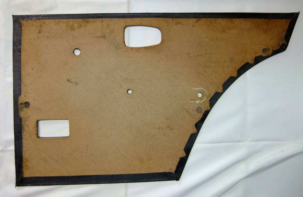

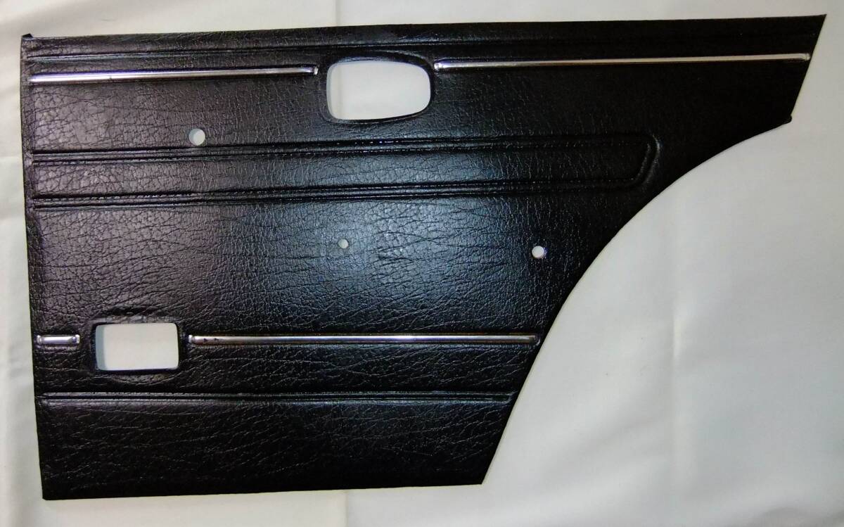

Rear Door Finisher
82900-H1000 STD Black
82900-H1100 DX/GL/GX Black
82900-H1101 DX Yellow
DX
15944.jpgAlbum 15944
GL
13933_sedan.jpgAlbum click to view
rear door
11179.jpgAlbum 11179
