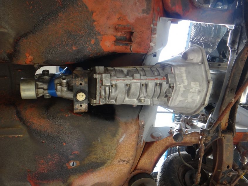

8706.jpgAlbum 8706
In your 1000 ute, with A14 and modified engine mounts, no modifying of the tunnel was necessary, and you can see the two holes in each floorpan where the custom crossmember bolted with sandwich plates. You may have noticed that Shaun welded new humps in the tunnel to bolt in the 4-speed, these will need removing again. It surprised me because with the same gearbox, the tunnel in my 1200 required some major cutting, and the rear of the box sits about 2-2.5 inches higher.
Reference and gearbox mount pics: Dellow 5 speed into 1000
