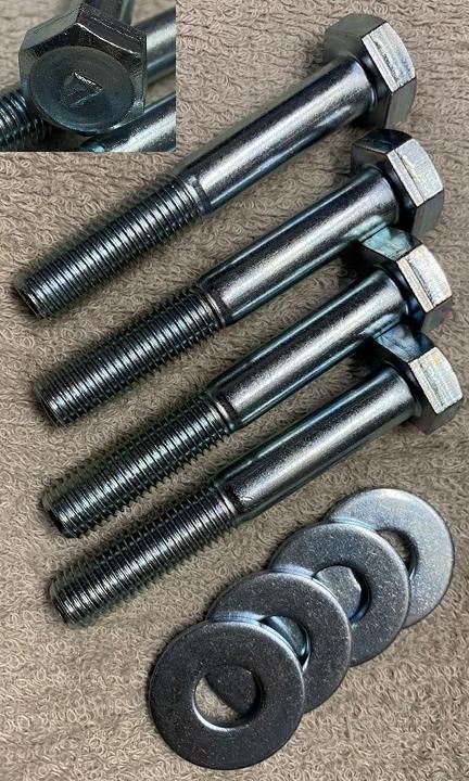

Bolts with body washers, JIS 7T (high carbon steel)
