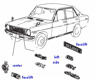

Front
Radiator grille - Center emblem
- 62312-H1626 EMBLEM SET-ORNAMENT radiator grille "D" Sedan Export
- 62312-H1026 EMBLEM SET-ORNAMENT radiator grille "S" early Sedan, Wagon
- 62312-H3125 ORNAMENT KIT-radiator grille late Sedan, Van
- 62312-H1826 SET-ORNAMENT radiator grille "D" Coupe Export
- 62312-H1825 SET-ORNAMENT radiator grille "S" early Coupe
- 62312-H4025 ORNAMENT-rad, radiator grille late Coupe
Radiator grille - side emblem (early)
Sedan Radiator Grille changed to fancy style for 1973(?) model year.
- 62330-H2026 SET-EMBLEM, radiator grille "GL" Sedan, Coupe early
- 62330-H2325 SET-EMBLEM, radiator grille "GX" Sedan (early), Coupe (early, late)
radiator grille - side emblem (late)
Sedan Radiator Grille changed to fancy style for 1972 JDM Facelift.
- 62330-H3125 EMBLEM SET-radiator grille "Deluxe" Sedan-DX
- 62330-H3325 EMBLEM SET-radiator grille "GL" Sedan, Coupe late
- 62330-H3425 EMBLEM SET-radiator grille "GX" Sedan
- 62330-H7225 EMBLEM SET-radiator grille "GX 5 SPEED" Sedan, Coupe

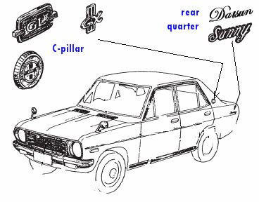

Side
Body Side C-Pillar
- 76852-H1000 BADGE-"Deluxe" SEDAN-DX
- 76852-H2001 BADGE-"GL" SEDAN-GL
- 76852-H2300 BADGE-"GX" (R.H.) SEDAN-GX
- 76853-H2300 BADGE-"GX" (L.H.) SEDAN-GX
Body Side Rear Fender
Rear quarter-panel mounted:
- 78841-H1800 EMBLEM-"Sunny" (early '71) Coupe
- 78841-H1850 EMBLEM-"Sunny" (W/Sealing washer) Coupe
- 78842-H1800 EMBLEM-"Coupe" (early '71)
- 78842-H1850 EMBLEM-"Coupe" (W/Sealing washer)
- 78842-H2201 EMBLEM-"Coupe GL" (early '71)
- 78842-H2251 EMBLEM-"Coupe GL" (W/Sealing washer)
- 78842-H2400 EMBLEM-"Coupe GX" (early '71)
- 78842-H2450 EMBLEM-"Coupe GX" (W/Sealing washer)
- 76854-H1000 EMBLEM-body side "Sunny" (early '71) Sedan, Wagon
- 76854-H1050 EMBLEM-body side "Sunny" (w/sealing washer) Sedan, Van-P, Van-DX
- 76854-H1600 EMBLEM-'DATSUN' BODY SIDE Sedan, Coupe Export

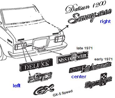

Rear
Trunk Lid Fitting (right)
Mounted on right side of trunk lid:
- 84822-H1000 EMBLEM-trunk lid "Sunny 1200" Sedan, Van-DX
- 84822-H1600 EMBLEM-'DATSUN 1200' TRUNK LID (cursive) Sedan Export
- 84822-H1806 EMBLEM-'DATSUN 1200' TRUNK LID (non-cursive) COUPE Export
- 84822-H1856 EMBLEM-'DATSUN 1200' TRUNK LID (non-cursive) COUPE Export (supercedes H1806)
Trunk Lid Fitting (left)
Mounted on left side of trunk lid:
- 84823-H1000 EMBLEM-"DELUXE" Sedan, Van-DX, Van-P
- 84823-H2001 MARK-"GL" Sedan, Coupe early
- 84823-H3300 MARK-"GL" Sedan, Coupe late
- 84823-H2300 MARK-"GX" Sedan, Coupe
- 84823-H7200 EMBLEM-"GX-5 SPEED" Sedan, Coupe
- 96905-18100 LABEL-loading capacity (Van, lower left)
Rear Badge (Center)
- 79202-H1825 SET-ORNAMENT REAR PANEL COUPE "S" early
- 79202-H4025 SET-ORNAMENT REAR PANEL COUPE "S" late
- 79202-H1826 SET-ORNAMENT REAR PANEL COUPE "D" Export
Rear Badge (Transmission Mark)
These are mounted to the left of the number plate:
- 79200-H1010 MARK-"Sports" Sedan-ST,Sedan-DT,Sedan-GT, Van-DX T
- 79200-H1060 MARK-"Sports" (w/sealing washer) Sedan-ST,Sedan-DT,Sedan-GT
- 79200-H1020 MARK-"Nissan Full Automatic" early Sedan, Coupe (left trunk lid)
- 79200-H2820 MARK-"NISSAN FULL AUTO MATIC" (From '71-Apr.) Sedan, Coupe (left trunk lid)
- 79200-H3200 MARK-"NISSAN FULL AUTO MATIC" late Sedan
These are mounted on left side of trunk lid:
- 79855-N2200 MARK-"NISSAN AUTOMATIC" SEDAN, COUPE (left trunk lid) Export
Location Unknown
- 96907-G1100 LABEL-4 speed Van-Std T, Van-P T
