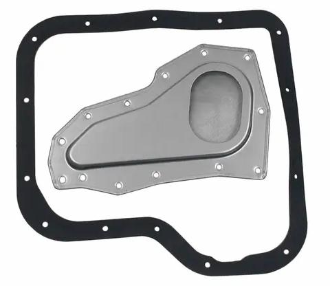

JATCO filter
30827.jpgAlbum 30827

Filter Kit
* ATP B61
