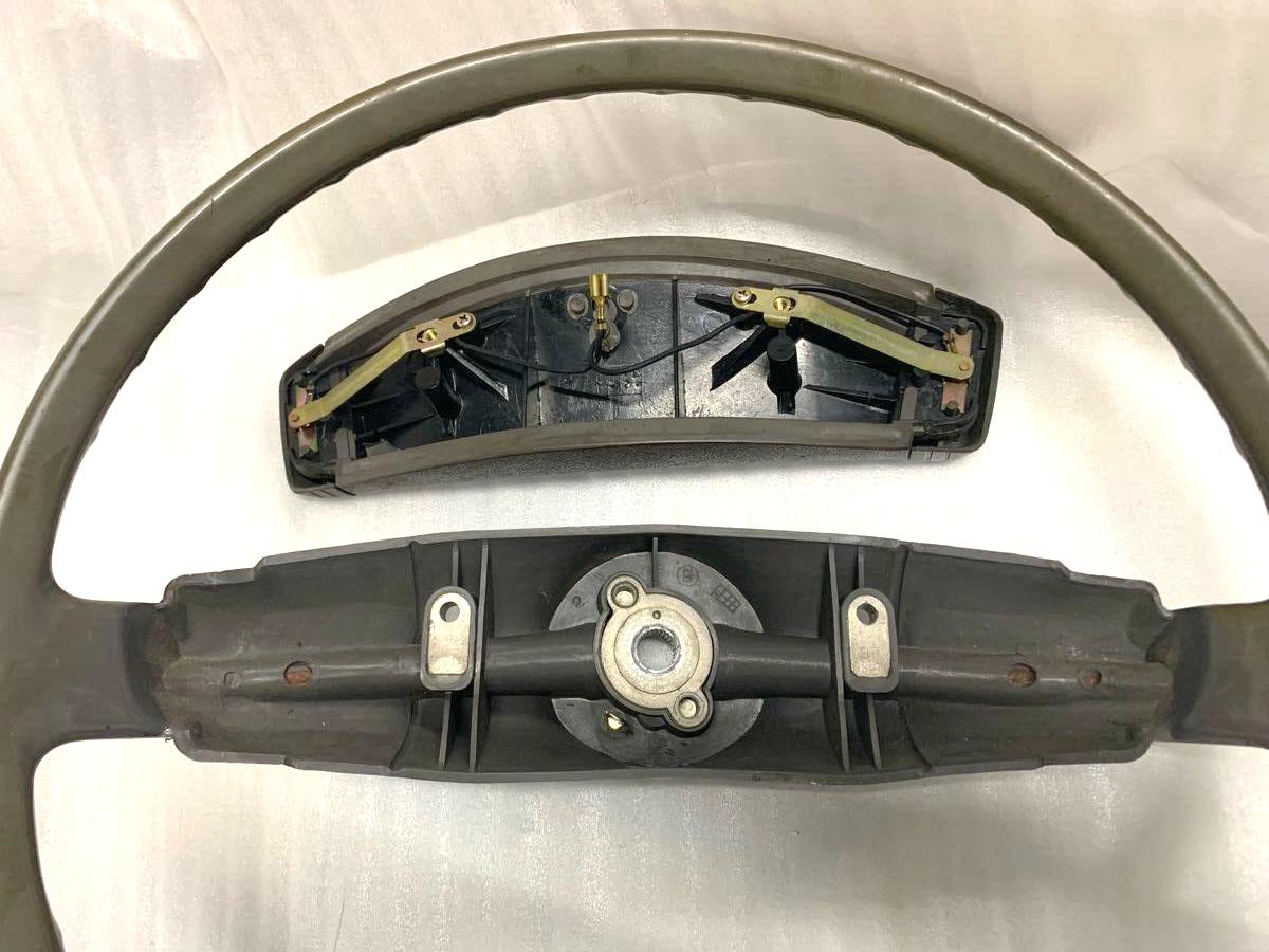

horn button attaches with two screws
31414.jpgAlbum 31414
