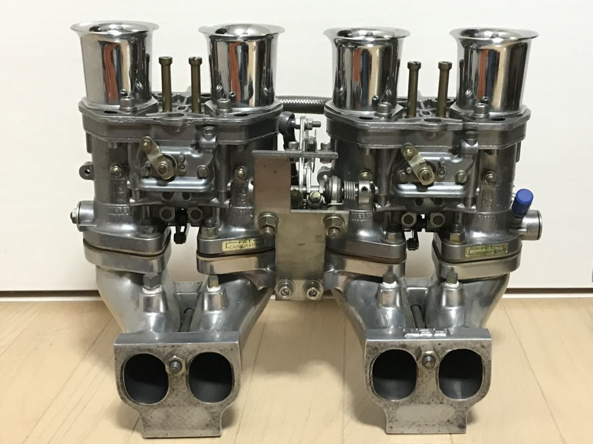

Weber DCOE
The great thing about these carbs (as well the Dellorto DHLA) is that the jets are externally accessible, even when the air filter is on. This makes jet changes at the racetrack a snap.
These are available in 40, 42, 45, 48, 50, and 55mm sizes. Most Datsun A-series street engines run the dual 40s. Note that there are different size venturis for the 40s. This "barrel" size (40 or 45) doesn't determine the airflow, which is determined by the size of the main venturi (choke). The 28mm venturi might work best for a street A12, while a 38 venturi would be good for an 8,000 rpm A14.

Dual DCOE
136.jpgAlbum 136
